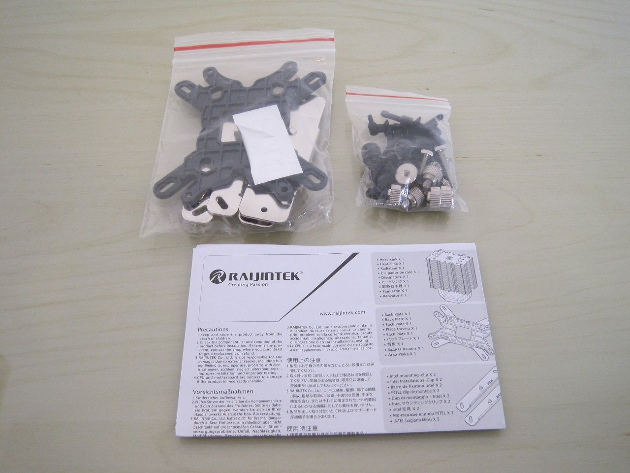

Packaging and Accessories.
IMG_3895_zpsa82df979.jpg~original
IMG_3900_zpsb379153f.jpg~original
Easy instructions to follow and a sturdy set of metal plates to hold the heatsink securely, extra rubber mounts are provided to allow push/pull with an identical fan and a sachet of thermal paste is also included.

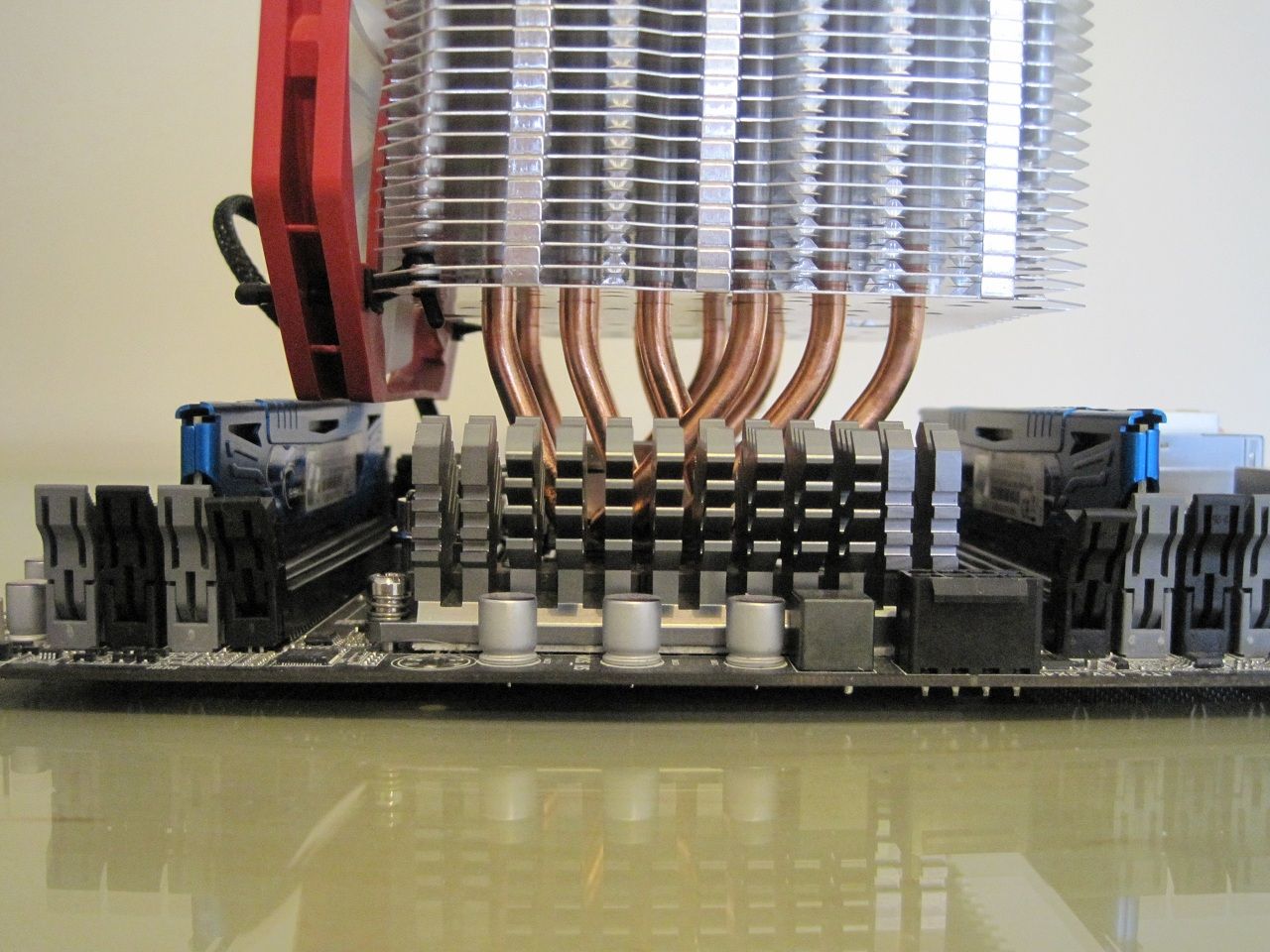

Memory clearance.
IMG_3987_zpsf4d60962.jpg~original
The fan hangs over the first slot and may touch some RAM, the above RAM is Gskill Ares.
IMG_3986_zps50d261f5.jpg~original
The rear hangs over the first RAM slot too, but without a fan there is plenty of room for all but the tallest of RAM.

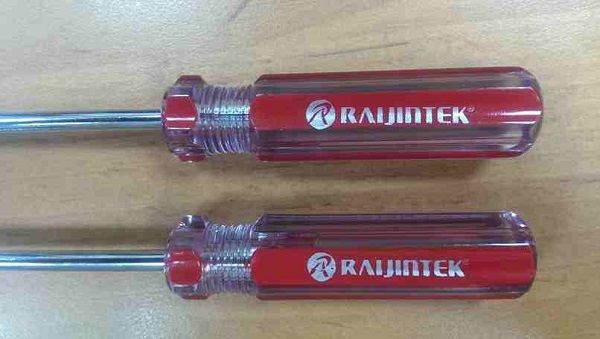

Review amendment/update,
I have been told that Rajintek are now bundling a screwdriver long enough to reach the screws with this cooler now.
