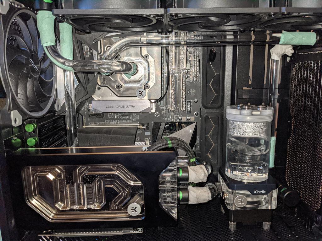

So not getting any feedback on the thermal pad placement I went ahead and did it as per the EK installation guide and then stripped down the case and removed the motherboard. I have now installed my monoblock which needed a plastic locating tab to be removed from the plastic shroud which needed a whole heap of screws removing plus the I/O shield removing for access.
I have now found that there aren`t any mounting holes for the PCI riser where I want it and as I have based my pipe routing around this I`ve had to order a box of assorted M3 screws, standoffs and nuts so I can mount it in the nearest vertical slot, these should arrive tomorrow so I should be able to make some more progress. I flushed the rads out last night and mounted the 360mm rad at the top but thats about it until I get the box of assorted screws.

53x4qVL.jpg All plumbed in, fill and leak test tonight :)

Last night I filled with de-ionised water and ran the pump for two and a half hours and there were no leaks.
Time to drain it, more difficult than imagined but the EK drain port is nice and tidy and looks better than the ball valves.

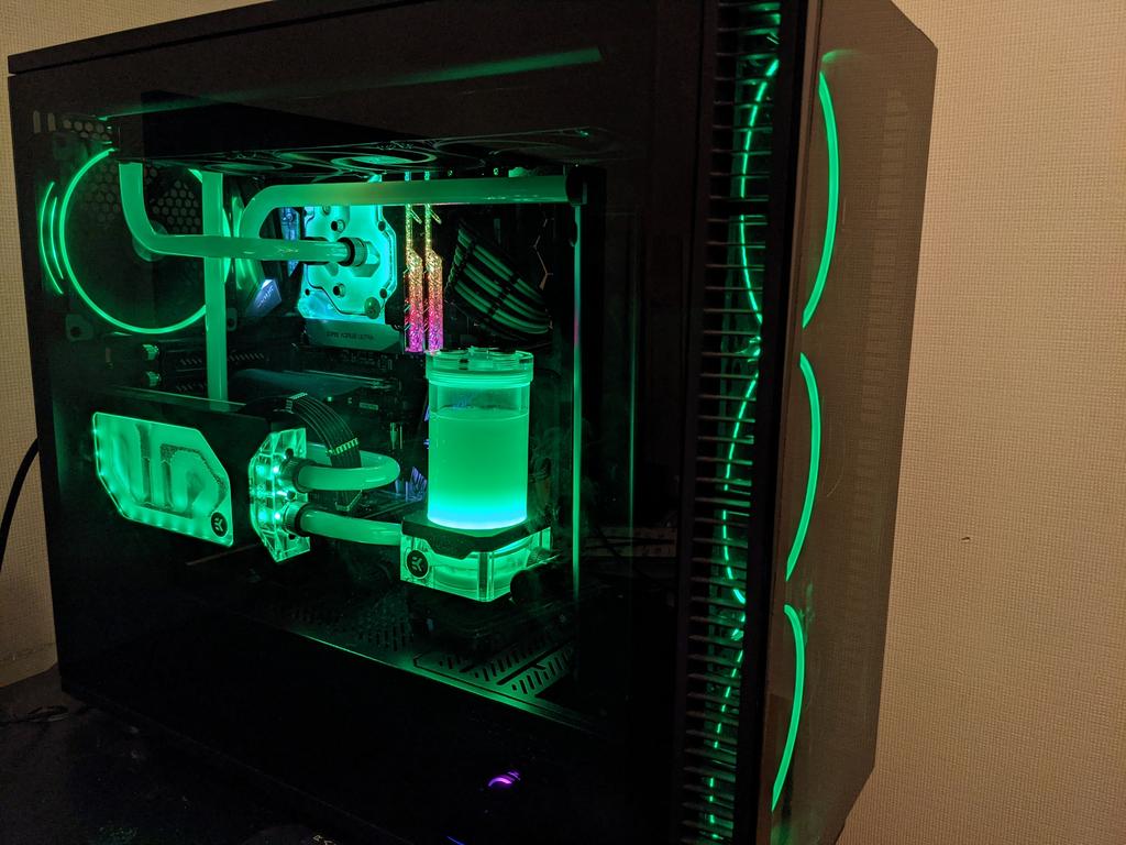

Then fill with EK`s Cryo Fuel, I went with neon green but looking at it I think acid green would have been better.
Tonight`s task is to connect everything back up, put the PSU back in and then see how the temps are :) Hopefully everything will be fine and I can get back to some gaming.

All up and running now, GPU temps in Heaven were 45 degrees but the CPU temps were a little high at 7o degrees with idle being around 39 degrees. Coolant was sitting at 29 degrees on idle.
I`ll see how it settles over the next week but I might need to repaste the CPU cooler.
