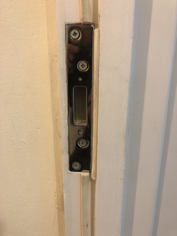

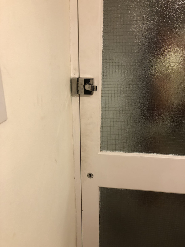

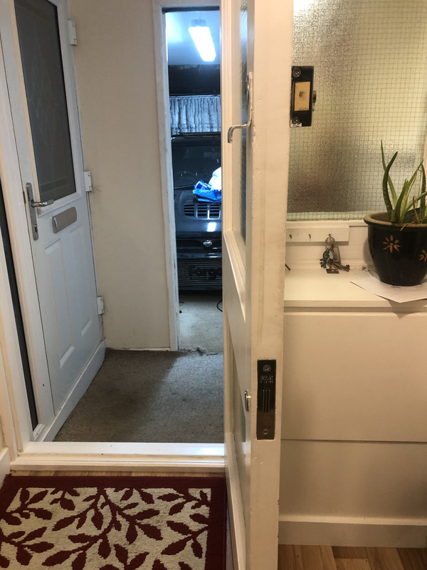

So I’ll post some pics of my door.
This is from the outside
This one from the inside
Side on
The mortise latch
And finally the night latch which if you look above and below you can see where the door frame has split when I kicked it open.
Not exactly fort Knox but enough including the upvc front door to put all but the most determined thief. Basically they’ll be looking at my neighbours houses before mine but no way would I just have a night latch in a million years.

I think we're talking at slight cross-purposes here. Your night latch actually looks reasonably well installed although there should be a plate that stops anyone sliding anything up or down through the gap to ease the night latch open. Indeed it wasn't the night latch that failed it was the wooden frame it was fixed into.
And if you look at your external door, and the protected hinges, and the three-point locking (operated by the handle with the Eurocylinder lock) on the outer door there is no comparison. You're not going to kick the outer door open. So for a quick entry they'd most likely snap the Eurocylinder and open the door with the handle.
I've seen security consultants (former thieves) gain entry to all sorts of locked buildings and the mortice lock will kick open (or with a breaching 'knocker') just as easily as the night latch. And there are BS certified night latches as well as mortice locks.
