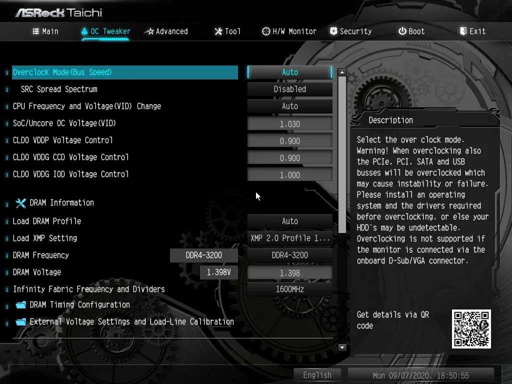

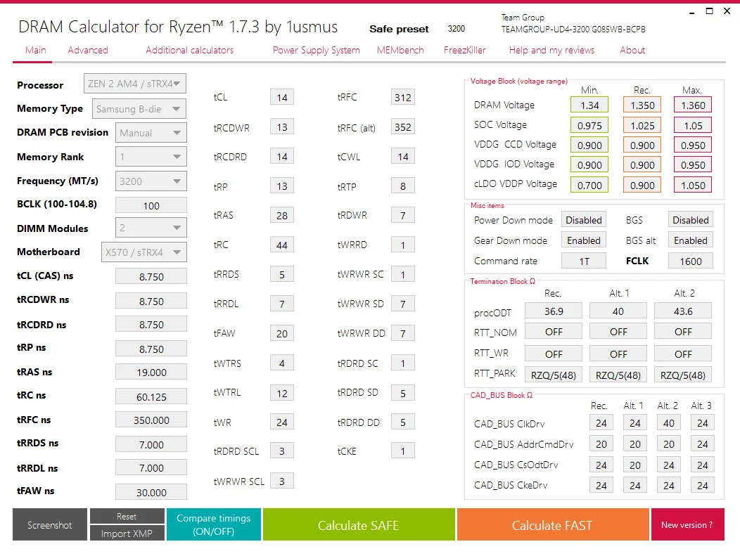

I have used DRAM Calculator and Thaiphoon burner but I just can't get the system stable.
I have only made the following change to try and get it stable, I have the RAM running 1.38, you can't set it to 1.4 on this board.
I get a blue screen a day with then error Attempted Write to Readonly Memory.
There is no pattern to it, just random blue screens.
Help!!!

I have tried loosening the timings with XMP enabled and the timings adjusted as per DRAM calculator and sometimes it won't even boot.
