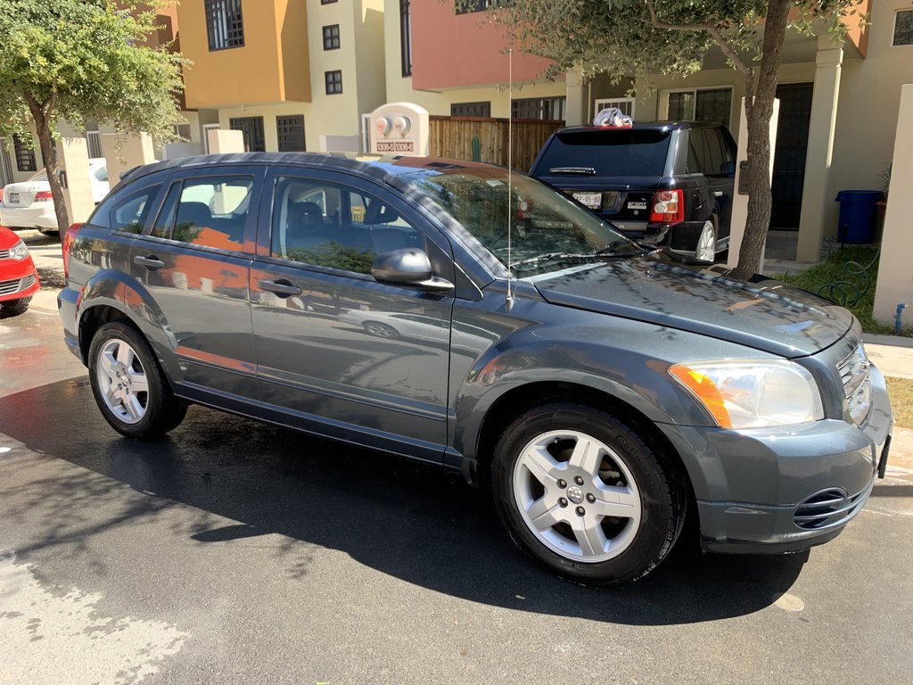

I can get it fixed up so cheaply though that it seems stupid not to. I had my Caliber totally resprayed with all dents removed for £200. Turned out pretty well, until someone went into the back of it a couple of weeks ago anyway.

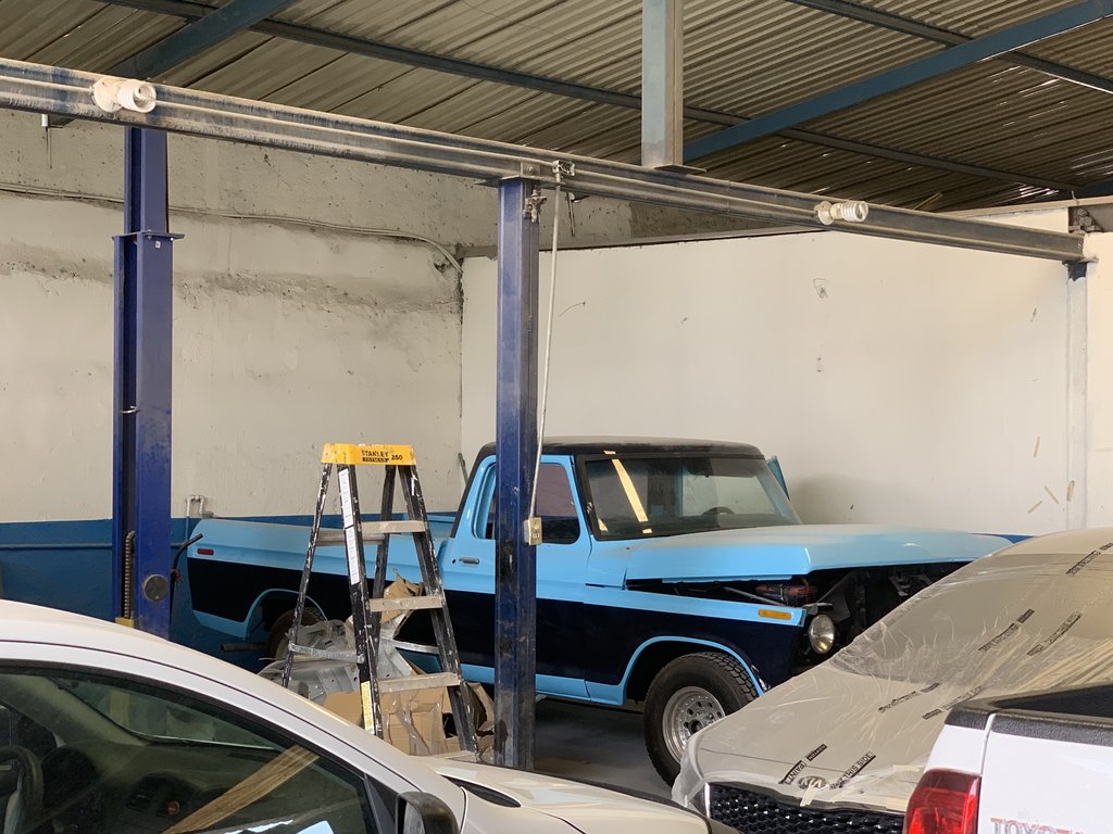

I also went to pick up my Caliber from the insurance body shop after it got rear ended, and they had this in the workshop. Kind of tempted to go two tone now, but I’m not sure.
