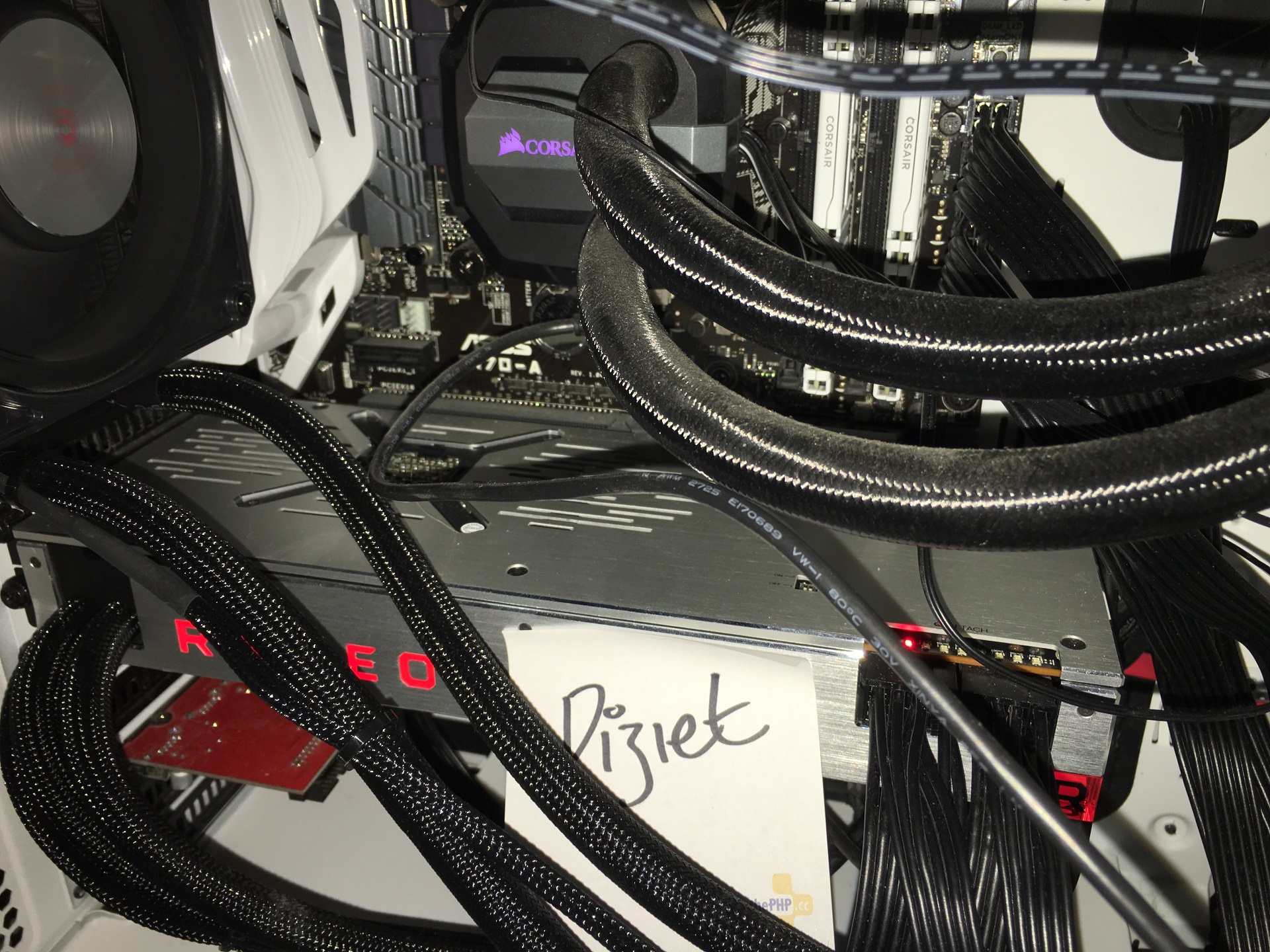

    My Vega 64 AIO arrived safe and sound on Tuesday, no Haribo though! Here's a photo for the record:
    [​IMG]

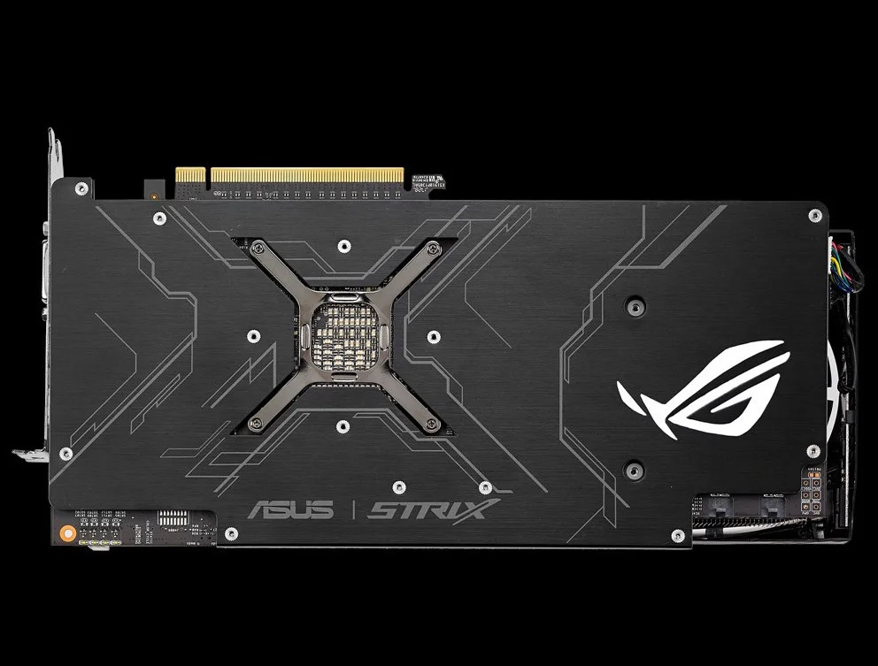

    Soooo.... Asus delivering a card that won't heat-throttle itself to death after a few minutes!

    It'd be good if the Sapphire Vega 64 Tri-x has the same short pcb and backplate as the Fury Tri-x did. The Sapphire Fury Tri-x was the reference Fury pro so of the three fans only 2 were covered at the back leaving one third of the heatsink with a fan and no backplate or pcb which let air flow through that part of the heatsink easier, AMD did a 3 fan Fury which they made there own pcb and backplate for, It was a full length design. This resulted in the Asus being both louder & hotter than the Sapphire reference pcb model. Basically it seems that it was the best of the bunch so I'll be keeping an eye out in the hope Sapphire develop a similar short pcb Vega, Sadly the fact that the reference Vega's are full length makes it unlikely. :( It's hard to understand how AMD got Vega so wrong. :confused:
